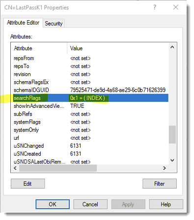

- Connect to the "well known Naming Context": Schema.
- Locate the custom attribute and open Properties.
- Locate the following attributes, their values should match the following (as shown below):
- attributeSyntax: 2.5.5.4 = ( NOCASE_STRING )
- searchFlags: 0X80 = ( CONFIDENTIAL )
Correctly Configured:
Warning: If the searchFlags attribute is not configured as CONFIDENTIAL (e.g., displays as INDEX), then you must configure it as CONFIDENTIAL.
Incorrectly Configured:
