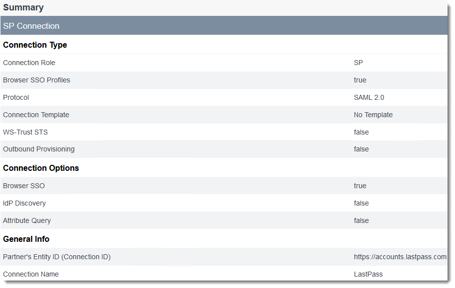

      1. Open PingFederate.
      2. Select Applications > SP Connections > Create Connection.
      3. On the Connection Template tab, enable Do not use a template for this connection.
      4. Select Next.
      5. On the Connection Type tab, enable Browser SSO Profiles.
      6. Set the Protocol to SAML2.0.
      7. Select Next.
      8. On the Connection Options tab, enable Browser SSO if not enabled by default, then click Next.
      9. On the Import Metadata tab, select None.
      10. On the General info tab, enter https://accounts.lastpass.com in the Partner's Entity ID field.
      11. Enter LastPass in the Connection Name field.
      12. Select Next.

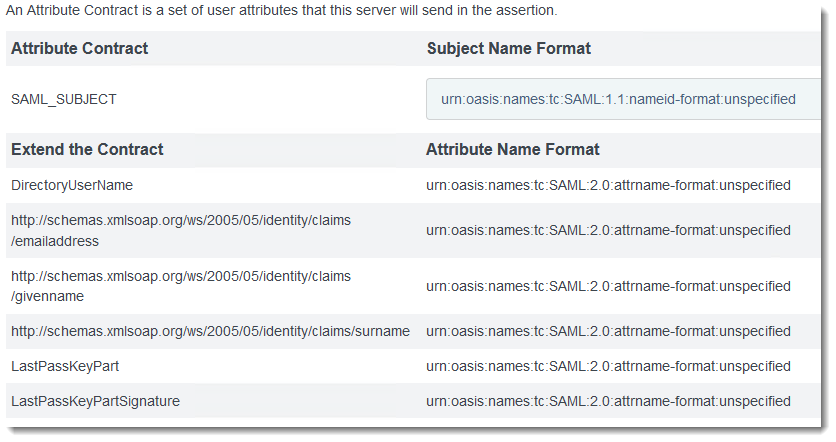

      6. Add the following attributes to Extend the Contract with the Attribute Name Format urn:oasis:names:tc:SAML:2.0:attrname-format-unspecified:
        • DirectoryUserName
        • http://schemas.xmlsoap.org/ws/2005/05/identity/claims/emailaddress
        • http://schemas.xmlsoap.org/ws/2005/05/identity/claims/givenname
        • http://schemas.xmlsoap.org/ws/2005/05/identity/claims/surname
        • LastPassKeyPart
        • LastPassKeyPartSignature
        Attribute Contract settings in PingFederate
      7. Select Next.

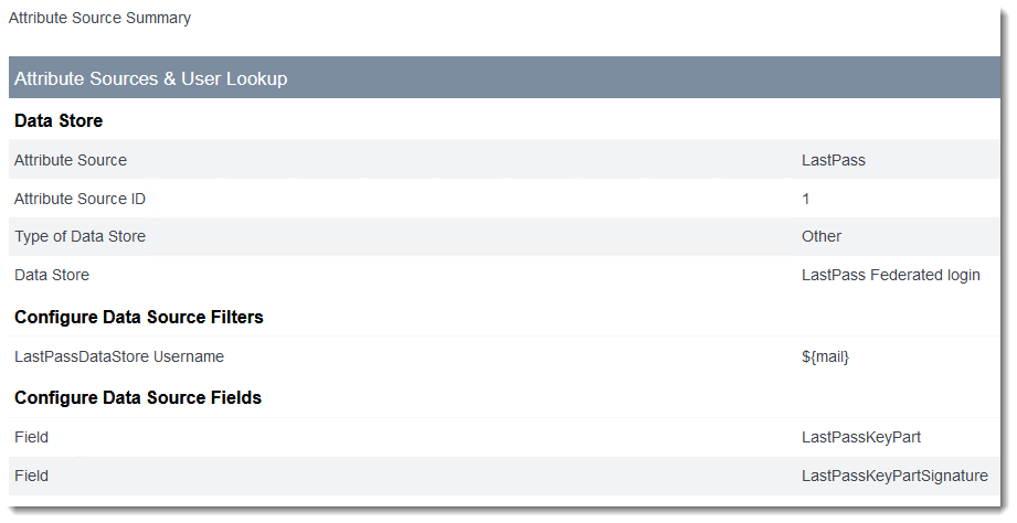

      Add the LastPass Data Store Directory attribute source.
      1. On the Attribute Sources & User Lookup tab, select Add Attribute Source.
      2. On the Data Store tab, configure the settings as follows:
        Configuration settings Instructions
        Attribute Source ID 1
        Attribute Source Description Enter your description
        Active Data Store LastPass Federated Login
      3. Select Next.
      4. On the Configure Data Source Filters tab, enter ${mail} into the "LASTPASSDATASTORE USERNAME" field (or enter the equivalent attribute name that contains the user’s email address).
      5. Select Next.
      6. On the Configure Data Source Fields tab, enable the LASTPASSKEYPART and LASTPASSKEYPARTSIGNATURE settings.
      7. On the Summary tab, select Done.

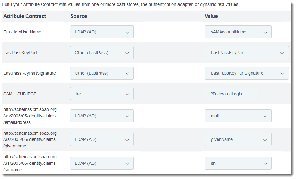

      Configure the Attribute Contract Fulfillment mapping.
      1. On the Attribute Contract Fulfillment tab, configure the settings as follows:
        Attribute Contract Source Value
        Directory Username LDAP (AD) sAMAccountName
        LastPassKeyPart Other (LastPass) LastPassKeyPart
        LastPassKeyPartSignature Other (LastPass) LastPassKeyPartSignature
        SAML_SUBJECT Text LastPassFederatedLogin
        http://schemas.xmlsoap.org/ws/2005/05/identity/claims/emailaddress LDAP (AD) mail
        http://schemas.xmlsoap.org/ws/2005/05/identity/claims/givenname LDAP (AD) givenName
        http://schemas.xmlsoap.org/ws/2005/05/identity/claims/surname LDAP (AD) sn
      2. Select Next.

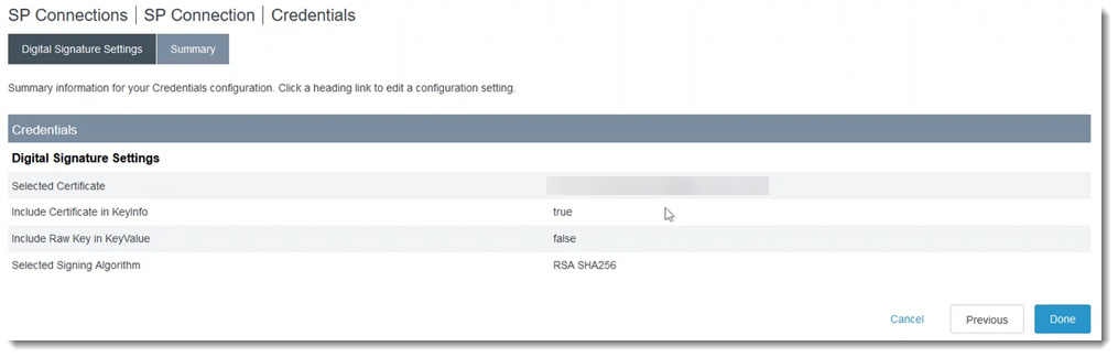

      Set the credentials.
      1. On the Credentials tab, select Configure Credentials
      2. On the Digital Signature Settings tab, select your Signing Certificate.
      3. Enable the INCLUDE THE CERTIFICATE IN THE SIGNATURE <KEYINFO> ELEMENT setting, and then click Next.
      4. On the Summary tab, select Done.
        Service Provider Connections Credentials settings in PingFederate
      5. On the Credentials tab, click Next.
